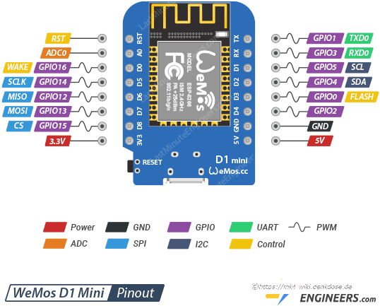

ESP8266 (Wemos D1)
https://lastminuteengineers.com/wemos-d1-mini-pinout-reference/
| Wemos Pin | ESP GPIO |
D1 | GPIO5 |
D2 | GPIO4 |
artikel:elektronik:wemos_d1:start
D1 | GPIO5 |
D2 | GPIO4 |
