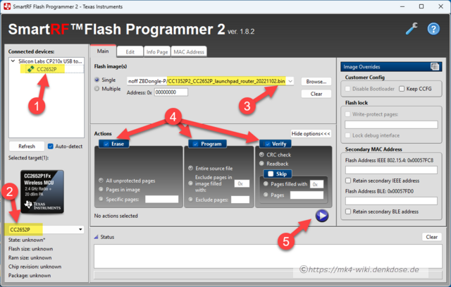

Firmware flashen
- Press the boot micro button (the one further from the edge) on the board.
- While holding the boot button press and release the reset micro button (the one closer to the edge)
- Selet Target „CC2652P“
